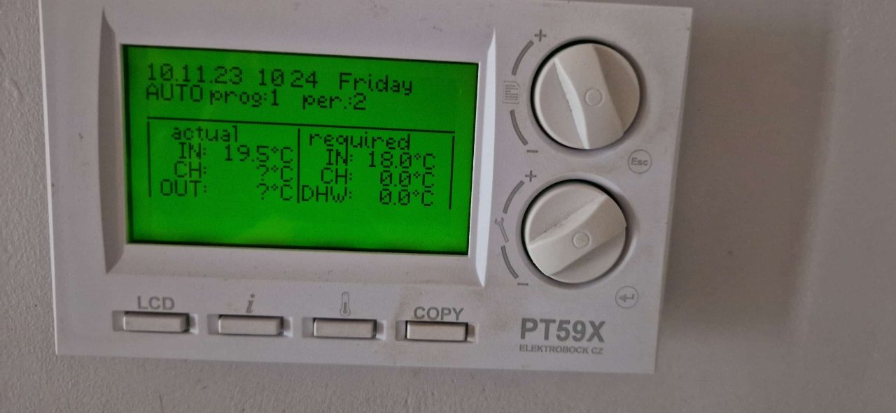

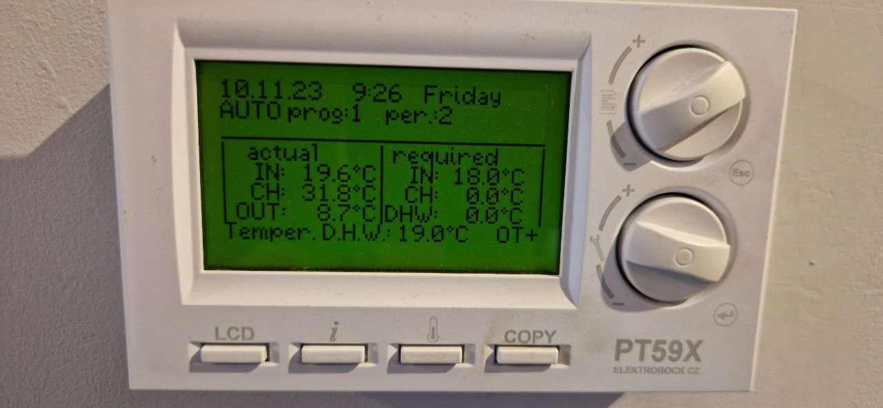

I have OTGW from nodo-shop. My thermostat is an Elektrobock PT59X and a boiler is DeDietrich MCR II. The communication between the boiler and the otgw works fine, but when I connect the thermostat, the communication stops. Also when connecting only the thermostat and the opgw, there is no communication, but the thermostat is powered. The green LED on the board does not flash. What should I check first to solve the problem? I am attaching a photo of the thermostat, which is connected directly to the boiler and through the gateway.
without otgw
without otgw
with otgw
with otgw

grzech wrote: Mon Nov 13, 2023 10:34 am What should I check first to solve the problem?
See the slave interface part of the trouble shooting instructions.

Hello,
I changed the USB cable, power supply and the gateway started working. otgw reads parameters from the boiler and thermostat. I have a question about my thermostat (it is not in the matrix, but there are others from this manufacturer - Elektrobock). If the thermostat does not support message 9, does it mean that I will not be able to overwrite the room setpoint?
