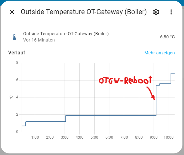

My NODO GateWay with Wemos1 has been running very well for more than half a year. Until now, the boiler had been used almost exclusively for domestic hot water. The home assistant integration and setting up the MQTT broker in HA were also quite easy. I also found an Otmonitor add-on by Bas Nijholt. This add-on enables the integration of the original Otmonitor from Schelte Bron into HA.
Well, before the heating season, I installed an outdoor sensor in the form of a waterproof DS18B20. It appears that it is measuring the temperature, although it updates somewhat infrequently. But then it gets stuck and only updates again after the gateway is restarted. HA usually has to be restarted to update the outside temperature. I hope you can help me.

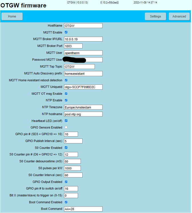

Here are my MQTT settings in OTGW.

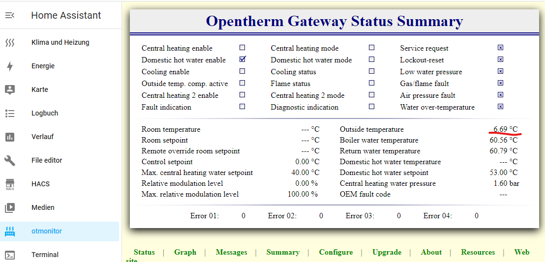

Here are my OTGW settings in Homeassistant.

There are two possibilities for connecting a DS18B20 to the OTGW: You can connect it to the PIC or to the Wemos. You only show information about the Wemos, which suggests that that's the method you're using. But then you don't have the "GPIO Sensors Enabled" option checked, which would be required to make it work.
So you'll need to provide much more details about how you connected the sensor. Also explain how you determine that "it gets stuck".
Finally, don't set AA=28 as a boot command. That will eventually fill the list of alternatives of the OTGW with lots of entries for MsgID 28. The OTGW stores this information in EEPROM, so you only have to do it once, not after each restart. And definitely not after each restart of the Wemos.

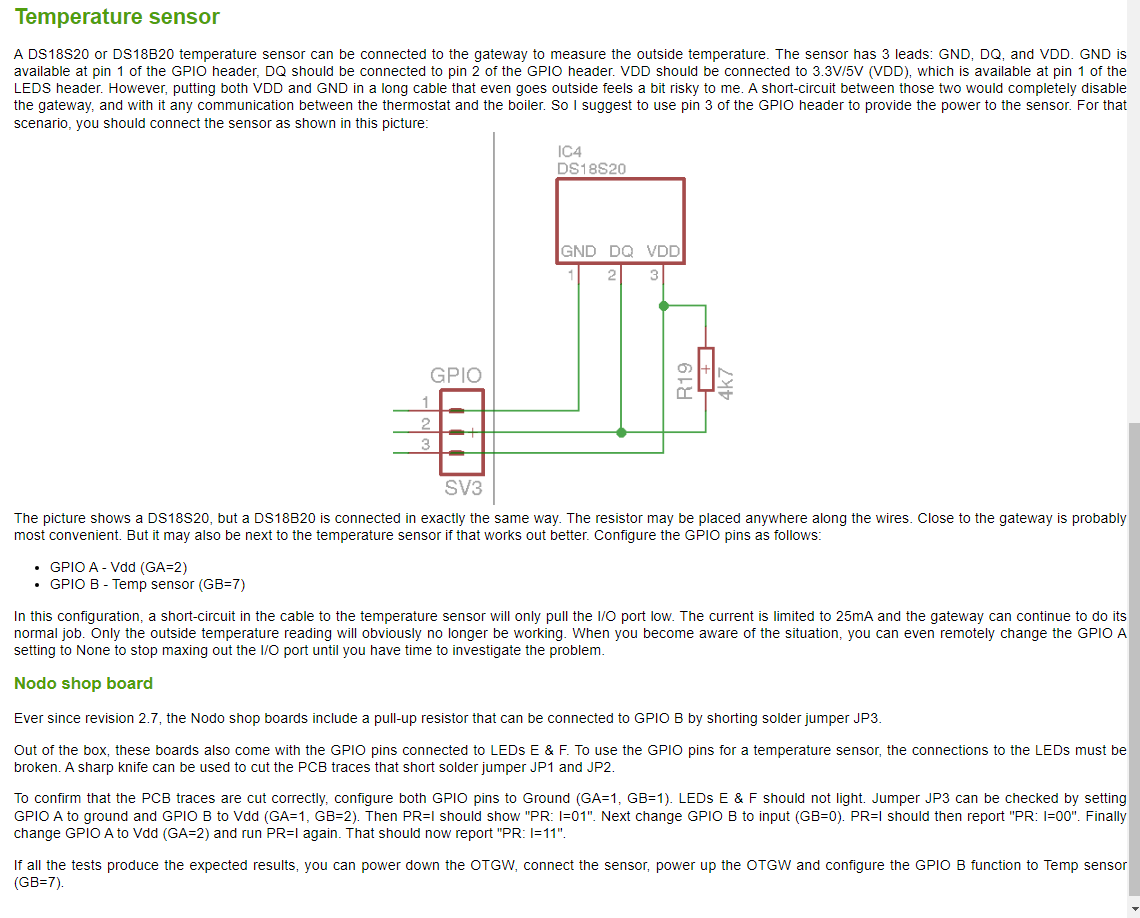

I installed the DS18B20 according to the specifications in the "NODO-Gateway" documentation and "otgw.tclcode.com/peripherals.html".

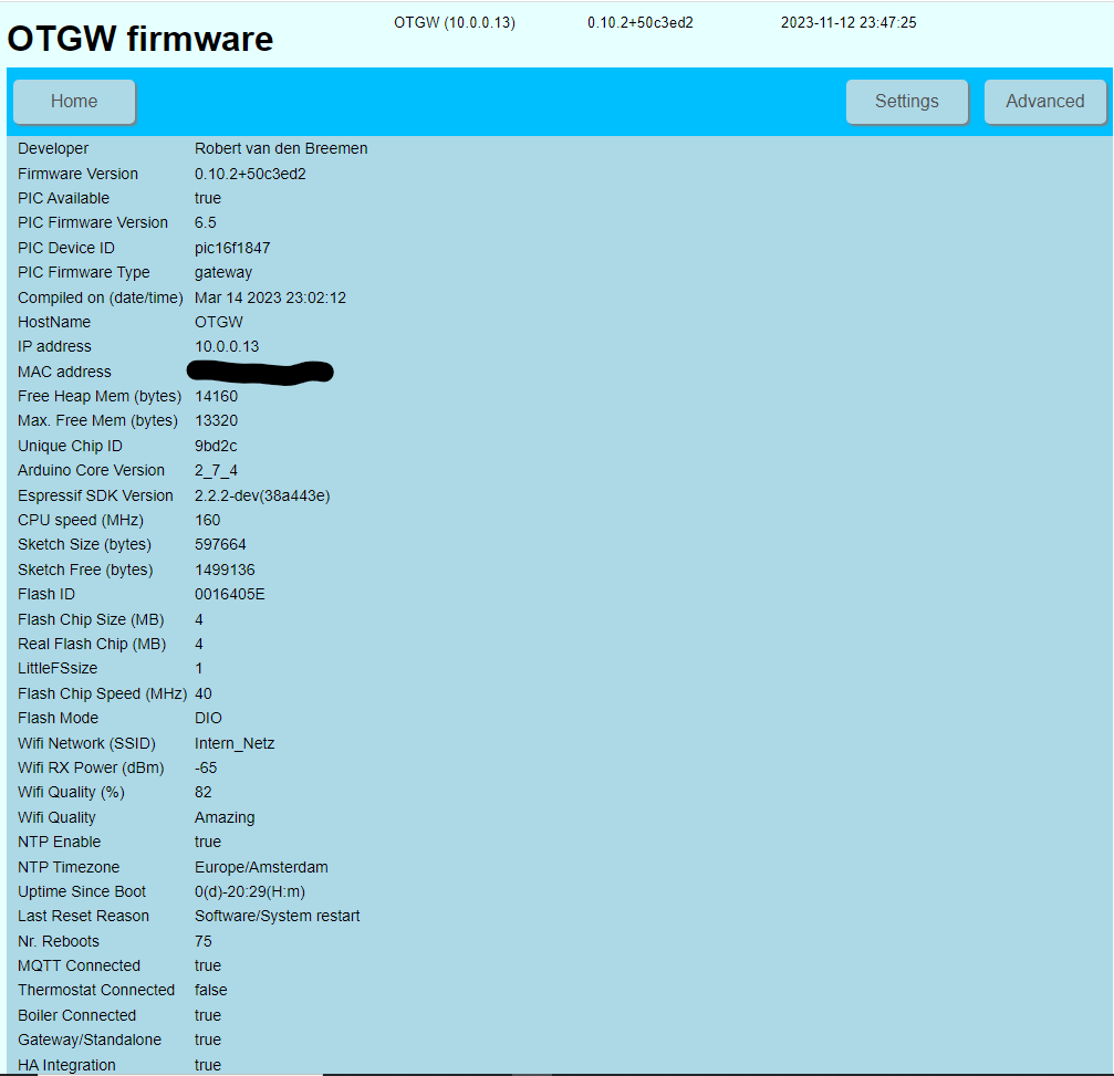

I would like to add an overview of the debug information.

I forgot to explain how I can tell that the temperature is not updated or only updated very slowly.
The measurement does not change until the gateway is restarted.

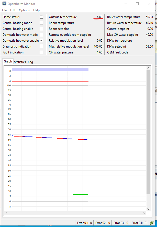

The temperature is also displayed in otmonitor.exe after the gw reboot.
sometimes even rebooting the GW doesn't help. You then also have to restart HA.
After the HA restart, the temperature is correct for the moment

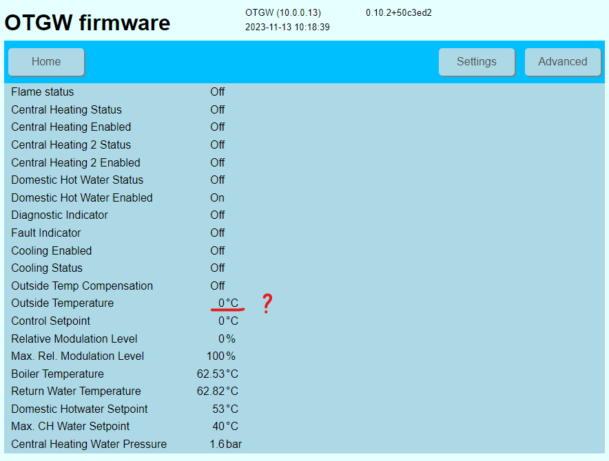

In the OTGW web version, the outside temperature is never displayed.
I hope I have provided all the information here to identify the problem.

When using the Nodo shop OTGW with a Wemos or NodeMCU, there are really actually two distinct parts of the device: The stuff around the PIC, corresponding to the original OTGW documented on the otgw site, and the Wemos/NodeMCU, which is like a mini computer talking to the OTGW part via a serial connection. For the OTGW part, you can refer to the mentioned web site. For the Wemos/NodeMCU part there are several options for firmware to choose from. For this part you need to refer to the web site for whatever firmware you installed.
You used the method described on the OTGW site for connecting the temperature sensor. For that method, the GPIO settings on the Wemos/NodeMCU are irrelevant. So I'm going to ignore that part.
Temperature sensors connected to the OTGW are only used to report either the outside temperature or the return water temperature to a connected opentherm thermostat. You indicated that you are using an on/off thermostat, not an opentherm thermostat. In that configuration, the measured temperature does not normally show up anywhere. You can only see it in a PS=1 report. So I am actually surprised you get a few readings after a reset of the gateway.
As in many cases, a message log could help to figure out what really happens. I suspect there must be something requesting PS=1 reports. That could explain why the Wemos/NodeMCU web site never displays an outside temperature, even when OTmonitor does. OTmonitor processes the PS=1 output. The Wemos firmware by rvdbreemen probably doesn't.
As explained above, the temperature measured by a DS18B20 connected to the OTGW is only reported to the thermostat. So it won't have any influence on the heating behavior of the boiler. Even if I would change the code to make the OTGW send the value to the boiler as well, I doubt the boiler would behave any different. The thermostat is the intelligence of a central heating system. Normally, when a boiler has an outside temperature sensor, the thermostat can request that information and use it in its calculation of the control setpoint. The boiler itself doesn't use it, to my knowledge. That's why the sensor is optional.
