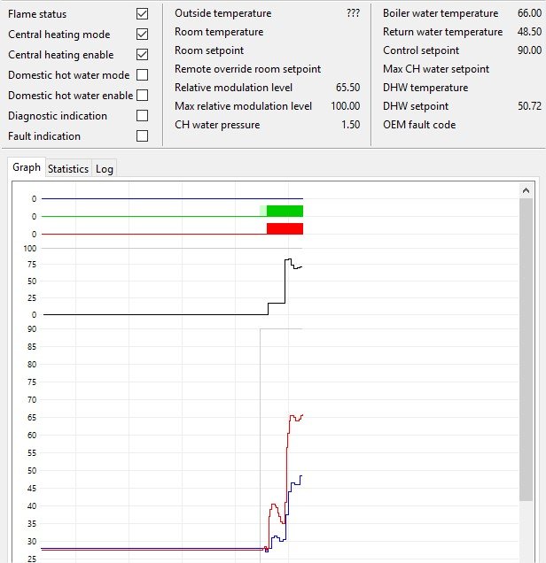

I recently had a new boiler installed. A Vaillant Ecotec Plus with a separate storage tank for sanitary water. This week the technician also placed the VR33 Opentherm module in the Vaillant, after which I also connected the OTGW module to the VR33 module. For the time being I still keep my old Multi-zone KNX thermostat that is connected to the OTGW input in on/off mode. And given the heat of the last few days, this relay has been open (off) for several days. Which according to the documentation corresponds to “stand alone mode”
1) OK: If, on my on/off thermostat, I force the heating in the kitchen to a high value, the thermostat kicks in and the Vaillant starts to burn. And the radiator in the kitchen gets hot. See the image of OTMonitor in the attachment OTMonitor1.jpg.

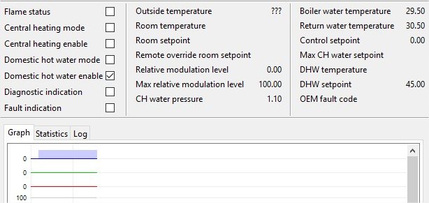

2) KO: the Vaillant boiler no longer heats the sanitary water of the separate storage tank since the VR33 module and the OTGW were connected.
3) KO: I have written a small program in Home Assistant that monitors the temperature of the storage tank and, when too low, sets the value “set_hot_water_setpoint” to 45°C and turns “set_hot_water_ovrd” to 1.
On the image otmonitor2.jpg, you see that OTMonitor has received both values. But the Vaillant does not start heating.

Indeed, after setting the value “otgw_dhw_ovrd_gateway_cv “ (= override dhw) in HA to 1 (= enabled), my Vaillant started immediately with the heating of my separated storage tank. Even without changing the “DHW setpoint” which remained on -0,0°C. And my Vaillant now heats the storage tank autonomously (without HA)
