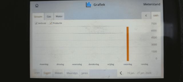

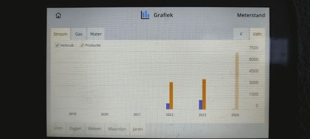

I updated the solar Panel; app yesterday (saturday 20-1-2024), but since then Solar production in days shows my panels produced 7418 kWh in one (that) day.
If that only were true... In reality this amount seems to matches my total production in the past (2) years.
How can I correct this or delete (just) that day's data?
By the way, it's a Growatt converter.
Thanks in advance for your help or advise.

So what you can do to modify:
1. get the ip adress of the toon and where x.x.x.x below, use your ipadress
2. identify the wron times and values in the hours table (epoch time, value) from:
http://x.x.x.x/hcb_rrd?action=getRrdDat ... 24%2014:00
3. correct this data by setting new values piece by piece (replace YYYYYYYY with the time in EPOCH and ZZZZZZZZZZ the new value:
http://x.x.x.x/hcb_rrd?action=setRrdDat ... ZZZZZZZ%7D
4. do the same for the days table:
5. correct the days:

Oeps... It;s still reading the total lifetime energy produced and writing it as my hourly / today's production.
I also seem to be missing today's hours now and it's showing an EPOCH value in the future(?)

How do I delete / correct / prevent the (apparently stil) incorrect value(s)?
