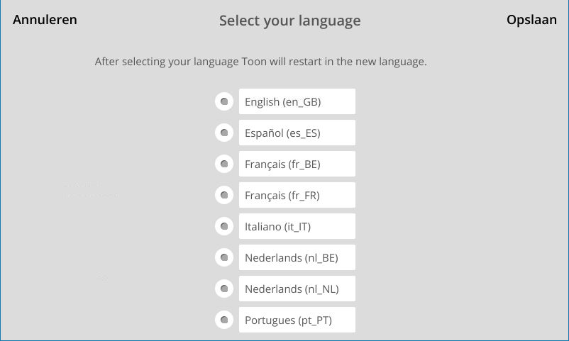

I just published my latest project on the Toonstore: Select Language (refresh your ToonStore data to make it visible)
This app will add a menu item which brings you to the language selection screen for Toon's user interface.
After selecting a language and press 'Opslaan' Toon will restart in a few seconds with the new language for all screens and apps.
All the current available languages on your Toon can be selected: English, Spanish, French (FR, BE), Dutch (NL, BE) and Italian.
The screenshot is also listing Portugues but that language is currently in translation and just there on my dev Toon.
If we can manage to add our own languages successfully I will publish a guide and material to translate for any volunteers.
Existing apps in the ToonStore where all developed in Dutch and specifically for the Dutch market.
Most of these (my apps for sure) will continue to be displayed in Dutch no matter what the language of Toon is.
