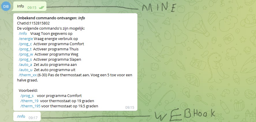

oepi-loepi wrote:so why not make it a webhook?
https://api.telegram.org/bot[BOT_API_KE ... SSAGE_TEXT]
This works, but still if i use this webhook, the toon bot is sending a message to me... and i'm not getting a responce from the toon.
Sorry i'm not a coder just a hobyist ^^
i'm using this webhookcode: https://api.telegram.org/botHere api key from the toon bot/sendMessage?chat_id=my own chat id &text=/example
Anyone that can tell me what is wrong :D
You are sending from the chatbot to your self. It should be the other way around. It should be in green, not in white.
edit: I think it will not possible to send a message with the api to a bot. (because a bot cannot send to another bot)
