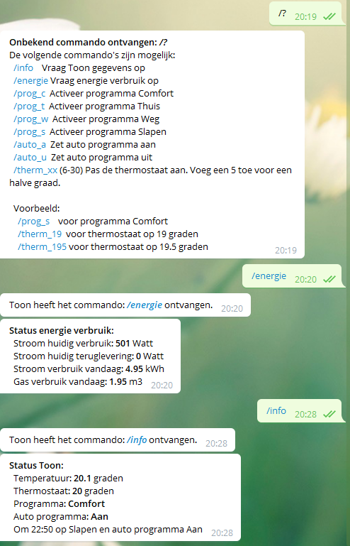

When a random character is sent from Telegram, it returns a message with the possible commands. The app will poll Telegram with a configurable interval. So a respons from Toon will arrive after this interval.

Example of Telegram messages:
