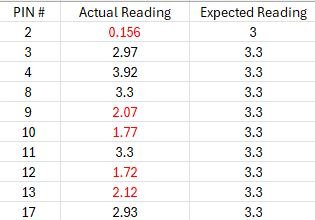

With the PIC in place, the voltages on the pins are as per the attachment showing out of range readings.

All the readings in red are I/O ports. The values seem to indicate that the PIC is not running its regular program, which would configure those ports as outputs. The really strange one to me is pin #4. 3.92V is quite a bit higher than the 3.3V supply voltage.
My first impression is that the PIC is either damaged, doesn't get power, or doesn't have the right program. When you apply power to the OTGW, do leds A, B, C, and D flash once, followed by led B flashing once per second?
You say all the voltages in the power supply section check out. So you measured 3.3V on pins 5 and 14 of the PIC? All the pins of the socket have been soldered properly? You did place the PIC correctly in the socket? The right way around and all pins in their respective holes? At no point did you power up the OTGW with the PIC in a wrong position?

Sorry for the typo in the table, pin#4 should have read 3.29v.

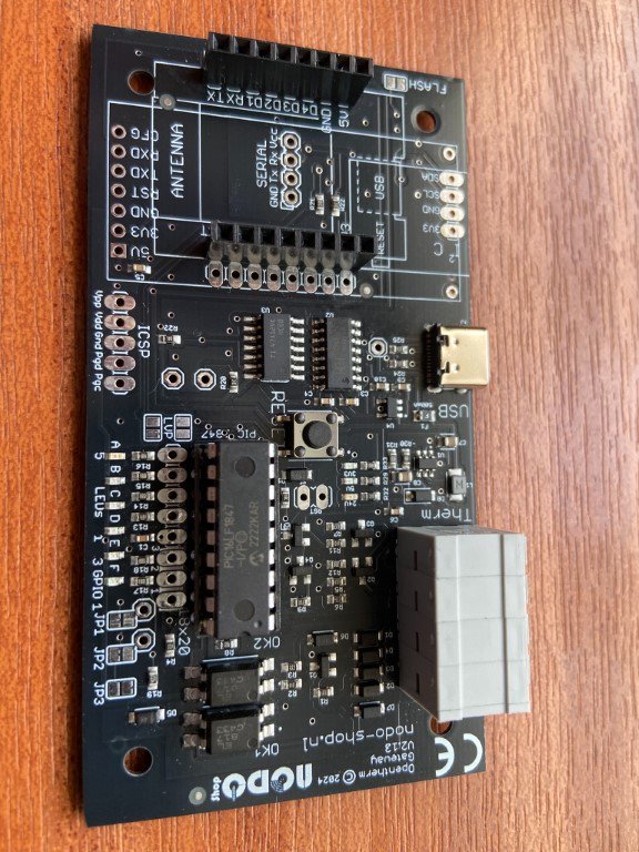

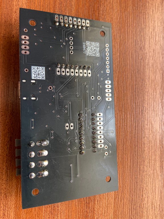

I've attached a couple of picture of the board for info.

Wait, does that imply that you have a PIC programmer? If so, it would be interesting to attempt to read the program from memory. That would confirm if the right program is loaded and that the PIC is functional.
