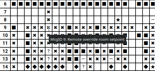

I have tried both Brave and Firefox browsers (under Linux Mint), but I don´t get any tooltips when hovering the mouse cursor over the MsgIDs ....

I must not understand what you are looking for. The tooltip uses the HTML title attribute, which has been around since the early days of HTML. It definitely works in both Firefox and Brave on linux. I just checked again:
The Opentherm spec on Ihor Melnyk´s site contains a list of MsgIDs in chapter 5.4, with more detailed descriptions in chapter 5.3. That spec was basically all the information I had when I created the OTGW. If that doesn't meet your needs, you will have to explain more clearly what you want.

You are correct; haven´t got a clue why the tool tips did not show up earlier, but they do now :oops:
