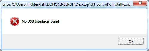

Every time i start de Color Editor software i get the following error, "No USB Interface found" after some 'investigation' it looks that my usb dongle

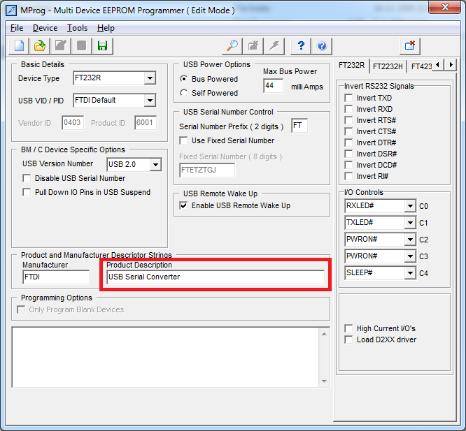

is reseted or cleared (or just broken :cry:). The USB dongle uses the FTDI F232R chip-set, with some software (MProg.exe) from the FTDI company you
can readout/re-program the F232R chip-set.

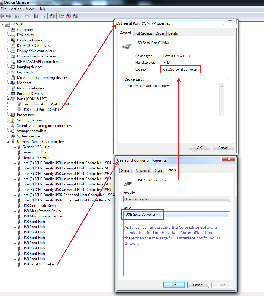

When i take a look @ the field 'Product Description' it now says "USB Serial Converter" (this description can also be found when looking via the
Windows Device Manager -> Universal Serial Bus controllers -> USB Serial Converter or Chromoflex)
. That's a strange point because the color editor
software is only looking for devices with an product description called "Chromoflex". So based on the above info the the error message "No USB Interface found" is valid.

    I'll try to attach some screen shots of the MProg software and the Windows Device Manager to clear some things up.
    For users who want to use the MProg.exe software... be carefull, make sure you first use the "Read and Parse" (via the Tools menu) option
    so you can use the "Save As" option to make a copy of your current FTDI device settings. (this tool allows you to upload (default?) settings also, brick up you device?)

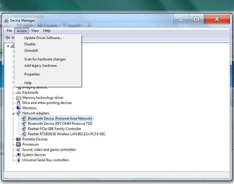

Richard did you try the option add legacy hardware... ( works for most non win7 drivers )
its in the devicemanager >> menu options >> add legacy hardware ( if i am right )
Helped me with a serial to usb device. Hope it works for you to.

Its kind of hard to find option i realised when i was looking for it again...
Select the device and the option shows as you see in the prtscreen. Just try this with older and stable drivers like vista or xp drivers.
