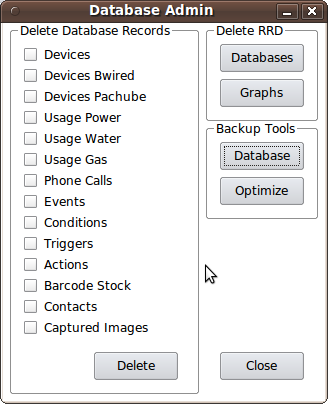

I found another bug:
Version: 278
When you re-init device list in "Database Admin",
the table structure of device is not correct.
Default value for lots of field are not add and more critical, fields have not same name as default database.
Personnaly, I don't understand why you don't just apply a "delete from devices" :roll:

RDNZL
Posts: 1008
Re: [Debug] DomotiGa v1.1.178 Error
Post by RDNZL »
You stay ahead of me just fine... haha, I fix you find...
I fixed the problems with devices deletion, I have added a bunch of other options along the way...
I do a TRUNCATE TABLE <tablename> now.
