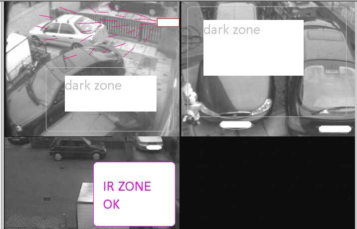

I Paul, the rule is every cam has its own illuminator.
If you use one for three , you will not have a good result. See image , it's faster to explain
Then it depends how dark is that zone during the night, i mean street lights , house's lights etc etc.
My solution for a similar problem was a 500w with IR sensor for people moving in your private zone, you will take nice pictures as in full light day.
Cheers, lorenzo.

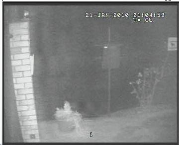

This is one of my camera, pal resolution with native IR (quite cheap, 115 euros). Outside is really dark, we live in a forest..............
