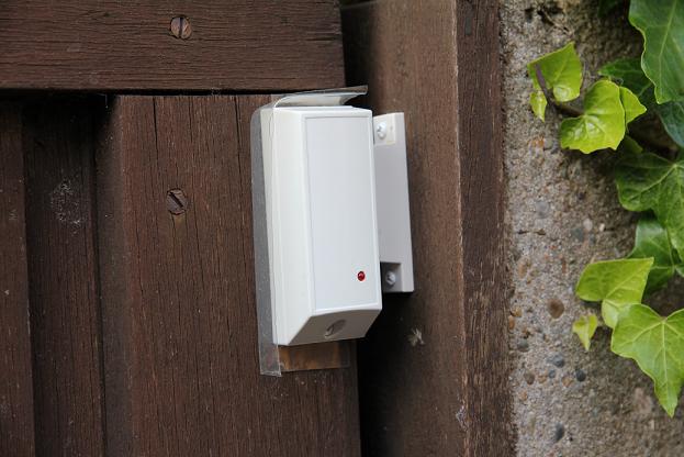

This is my solution, just a small piece of transparant plastic. Works perfect for more then a year now (incl. snow, heavy rains etc.)

Today I mounted my MCT-302 outside. I decided to put the internal print in a plastic bag so hopefully that will be enough.
We'll see.
I'll check after a couple of weeks whether it's still dry inside.
