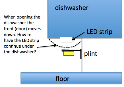

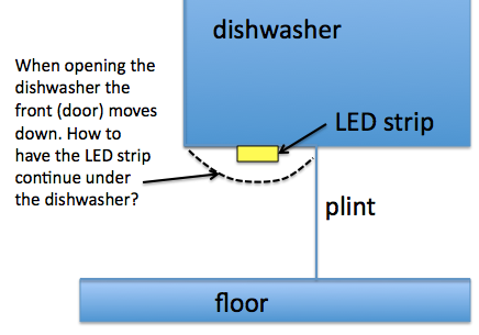

I'm very curious to see how other people solved this. I want to add LED strips below my kitchen cabinets.
Problem: When my dishwasher opens it would break the LED strip as it moves down (see picture).
Side-view
Solution: cut the LED strip in 3 parts: before-dishwasher, dishwasher, after-dishwasher (don't really like this)
Solution: cut the LED strip in 2 parts and don't mount it under the dishwasher (don't really like this)
Has anyone done this before? How?

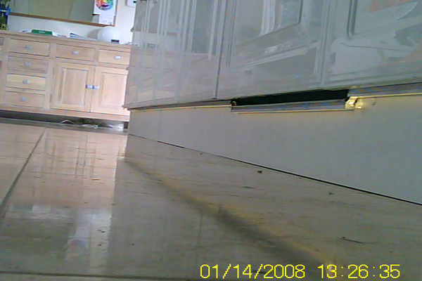

Here's how i did it:
When the dishwasher door is completely horizontal (open), the door goes "into" the plinth, so under the dishwasher door there has always been a small gap in the plinth. This has always been like that. What i did was glue a "hoek profiel" (sorry) on the inside of the plinth resulting in a horizontal surface sticking out at the gap in the plinth. That way i could attach the aluminum U-profile to it and i didn't have to cut the LED strip at all:

Hi DJf3,
As Digit discribe this is the way we solve it either by our customers.
You can use a L or U alu strip and mount this to the side of back onder the diswasher ( the fridge is also a problem device in kitchens :D )
By some of our customers we made a disconcteble strip by each device, so when a device is broken. You can simple unplug the plugs and remove the broken device.
