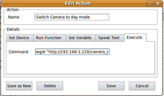

Hi
Still very new to DomotiGa and this forum, but I'm being more and more impressed by Domotiga - A very flexible HA program.
I have a need to reconfigure my camera at sunset and sunrise, and was thinking: Well, DomotiGa knows when it is sunset...
So I added a new action type: Execute external program. See attached screen shot.
Edit Action Form
Edit Action Form
The patch is against revision 372. I hope others will find it useful. And that Ron will include it in a future version.
Best regards
hhg
execute_action.patch.tar.gz
(881 Bytes) Downloaded 294 times

thanks for your work!
Will add it to the code repository once I have cleared my jet-lag after returning yesterday from a long stay in Indonesia.
Will also post other DomotiGa code still laying around here.
Regards, Ron.

I have added your code to revision 390.
Thanks.
Regards, Ron.
