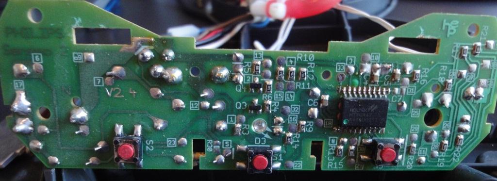

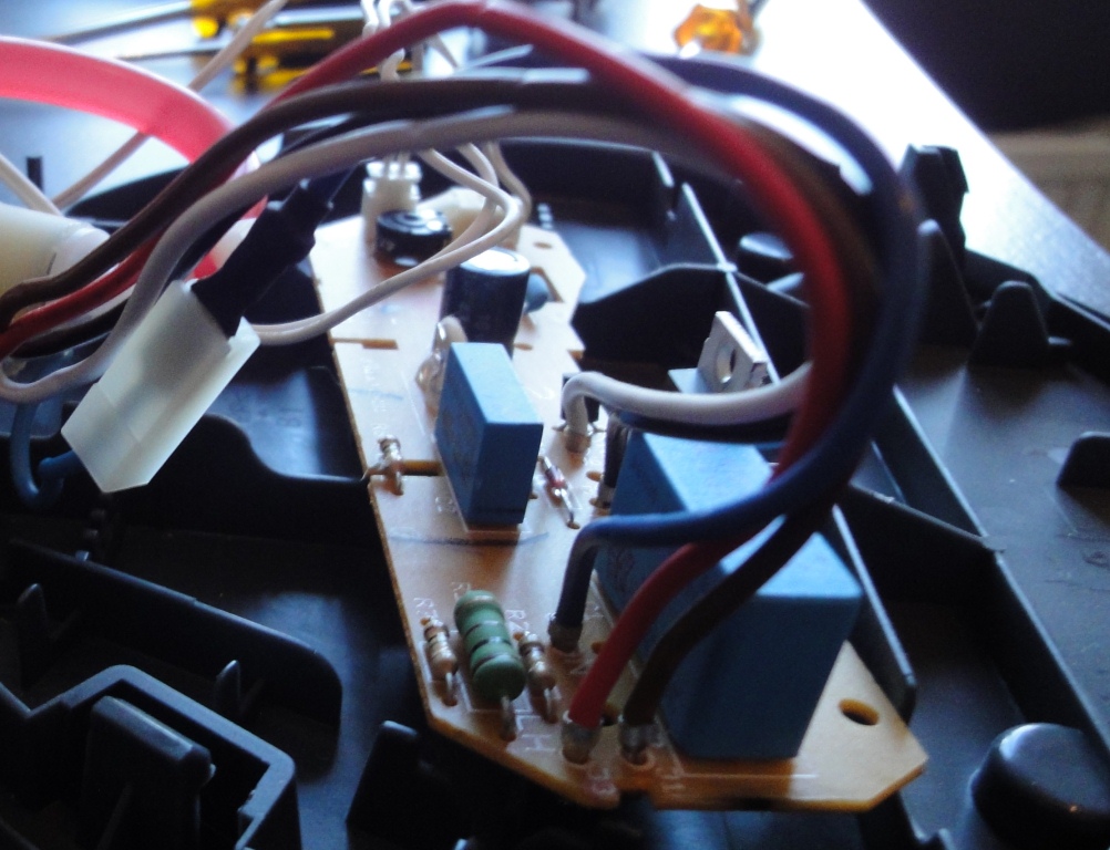

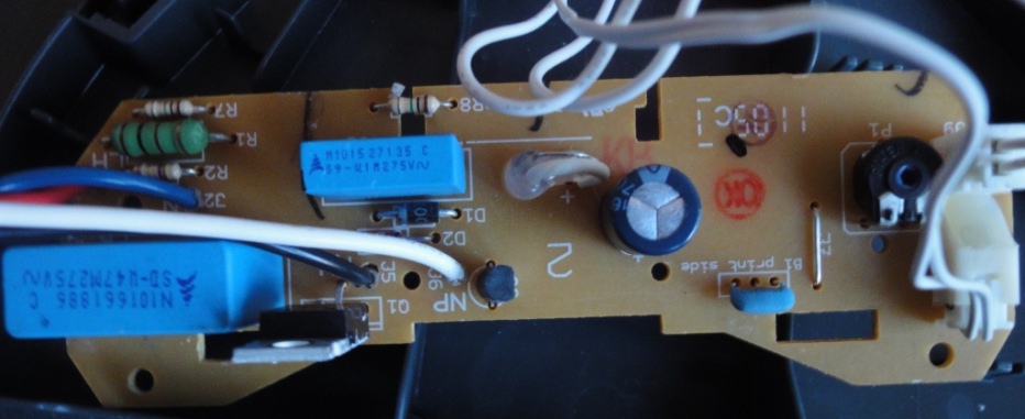

The middle red button is the power button and to boil the water
Senseo circuit board 3
Senseo circuit board 2
Senseo circuit board 1

Damn, those Senseo prints looks like they come from the 80s.

Anyway, Looks like the Senseo print is low power (verify if it is).
switch S1 is the on/off push button.
Check if the duwi is a low power on/off switch too.
If both are, measure/figure out the signals on the S1 pins.
Like it makes a contact between the left and right side when you push the button. (eg. pulling a signal up or grounding a pin)
You could probably connect the duwi on top of the S1 switch making them both functional.
However, you should measure the signals, check what chip is on the print, follow the tracks etc.
have fun..

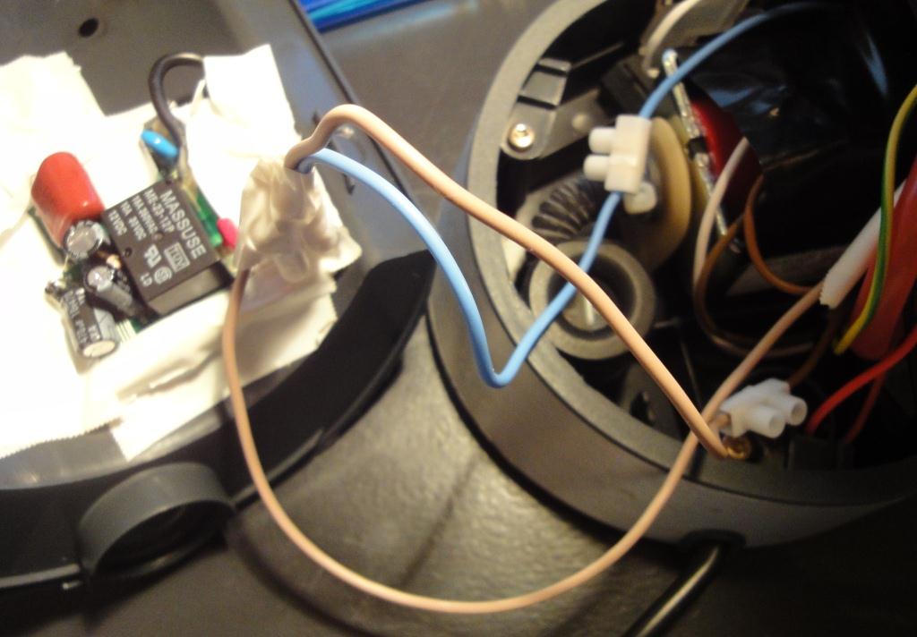

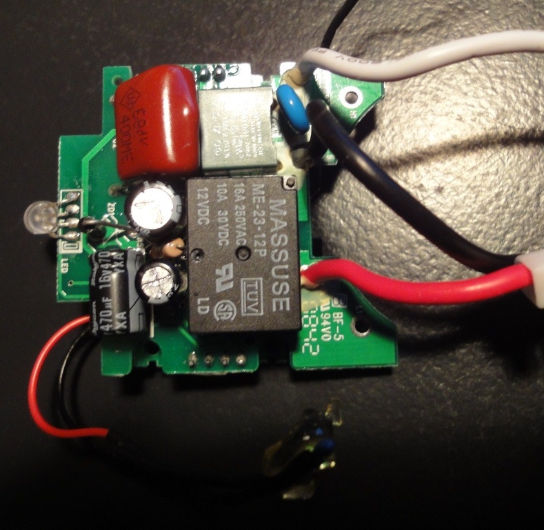

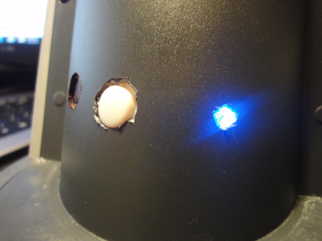

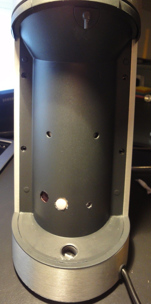

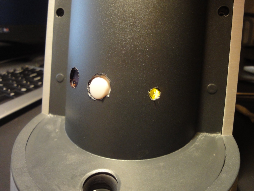

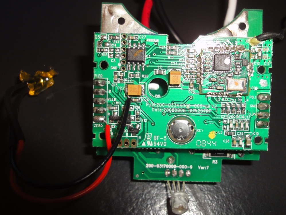

Oke, just some pictures. It is work in progress :D
The white button on the back you can use to switch it on/off manualy
The yellow LED indicates its on
The Blue LED indicates its Off
For now i can turn the power on/off. When i stuck the (boil/power) button on the front of the Senseo and i switch it on, it begins to boil the water :D!!! Really funny to control your Coffee machine with my iphone/ipod

The z-wave chip pasted at the back
