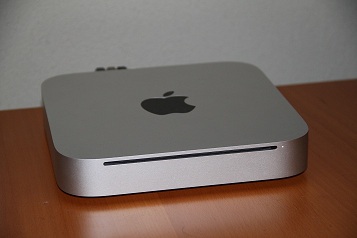

It's done!
Bwired.nl and all my home automation stuff is running now on a Mac Mini 2010 with 2 x 2.4 Ghz and 4GB memory.
The OS is Windows 2008 R2 64bits server running solo without tools like Bootcamp.
So currently the Mac Mini Bwired manages my Home automations software and also easily thousands of Web pages viewed daily on Bwired.nl.
The main reason for me to switch to the Mac Mini is obviously the low power consumption.
And the energy usage of this little powerhouse is amazingly low, the Mini consumes 9 watts idle including Windows Server 2008 R2.
A fully equiped Bwired server currently consumes an average of 23 watts and that includes:
UPS (8 watts)
VSComm USB-> 8 x RS232
2 x USB Receiver RFXCOM
Active Dual Display Adapter Apple DVI 2560 x 1600
Plugwise Zigbee USB receiver
Windows 2008 Server R2 64 bits
MySQL 5.1 Database 64 Bits
MYSQL Connector 5.1 64 Bits
MySQL Connector 3.51 32 Bits
IIS 7.5 Web Server
IIS 6 SMTP Server
Home Control Software Bwired 32 Bits
AVG Virus
MS Office 2010
Software Development Tools
The old AMD Bwired server was much slower, had a 32 Bit OS and spent an average of 80 watts,
so much as a saving of around 57 watts per hour.
