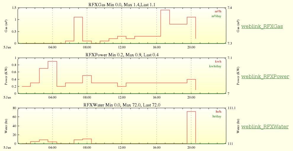

With much help of Willi Herzig, we got in fhem also support for the rfxmeter.
Here some screenshots and configs
RFXMETER:
RFXGas (CNT: 2104.17)
RFXPower (CNT: 7820.434)
RFXWater (CNT: 211419)
fhem> l RFXPower
Internals:
CODE 01
DEF 01 0.001 kwh
IODev RFXCOM
NAME RFXPower
NR 9
STATE CNT: 7820.451
TIME 2011-01-05 20:14:52
TYPE RFXMETER
scalefactor 0.001
unitname kwh
Readings:
2011-01-05 20:14:52 meter 7820.451 kwh
Attributes:
room RFXMETER
fhem> l RFXGas
Internals:
CODE 02
DEF 02 0.01 cu_m
IODev RFXCOM
NAME RFXGas
NR 12
STATE CNT: 2104.2
TIME 2011-01-05 20:15:24
TYPE RFXMETER
scalefactor 0.01
unitname cu_m
Readings:
2011-01-05 20:15:24 meter 2104.2 cu_m
Attributes:
room RFXMETER
fhem> l RFXWater
Internals:
CODE 00
DEF 00 0.5 ltr
IODev RFXCOM
NAME RFXWater
NR 6
STATE CNT: 211429
TIME 2011-01-05 20:15:23
TYPE RFXMETER
scalefactor 0.5
unitname ltr
Readings:
2011-01-05 20:15:23 meter 211429 ltr
Attributes:
room RFXMETER
