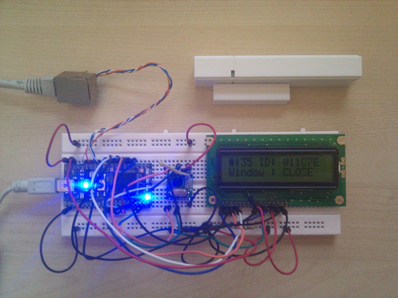

I bought some nice door/window sensors from ELV almost a year ago.
They are cheap, look nice, but no support to read them was found, bummer :|
http://www2.conrad.nl/goto.php?artikel=616101
I believe they are the same ones as shipped with the thermostat controls.
Past weekend I started playing with the free mbed evaluation board I got via Elektor some time ago.
http://mbed.org/handbook/Tour
While looking for some nice project to build I searched the mbed site and stumbled upon a project from Charly, which you can find here.
mbed.org/users/charly/notebook/connecti ... ct-to-knx/
He has plans to connect the interface to his freebus hardware (KNX), a great idea.
(BTW: This site is an enormous source for electronic projects and info even if you don't have a mbed!)
So I build the circuit on a breadboard containing my mbed dev board, an rfm12bs (removed from a jeenode, sorry!) and a display I had laying around.
I kindly got the alpha code from him, loaded it, and it works!
Now I'm busy coding tcp socket code so I can access it from DomotiGa over the network, the lcd is just for testing.
The mbed has a buildin ethernet interface, so only a RJ45 socket needs to be added...
It has a zillion other ports and interfaces btw so Arduino/Jeenode eat your heard out. :)
I like mbed!
The code is not 100% error free yet, so more on this project will follow, either here or on domotiga.nl

Ron if you want to know more about the protocol for this TF device check this site: http://fhz4linux.info/tiki-index.php?pa ... 20protocol
This device you're showing is a fht80tf used by use FS20 freaks in our FHT heating control systems :)
They're probably nog the cheapest devices, but by far the smallest I've seen sofar.
They're sending devices only. They don't respond to status requests from what I've experimented. (I have 8 running)
They send out a status every 4 minutes.
If you need any help, besides writing code, i'm willing to help.
My way of reading out these devices is via a CUNO device, if needed I can provide RAW communication dumps directly from the CUNO.
Jelle
