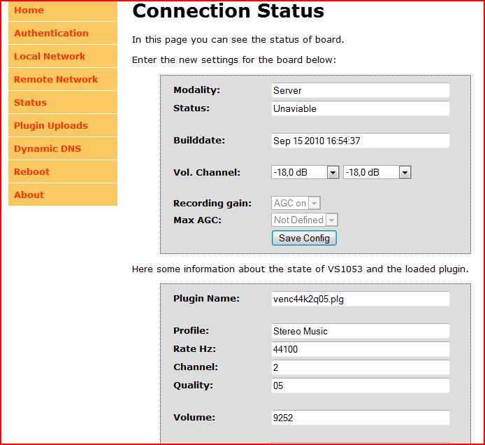

I have bought 2 boards : they are the same and you can set (client/server) with a jumper onboard.
CLIENT (yes it seems a mistake, but this is the name given by producer) SENDS AUDIO
SERVER RECEIVES AUDIO

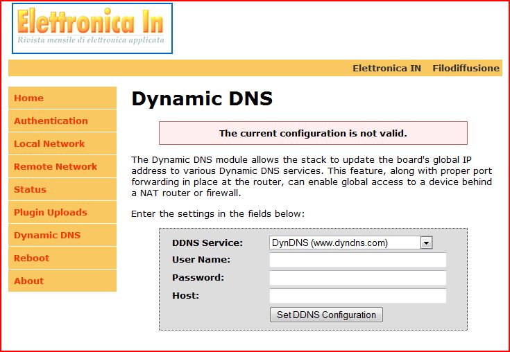

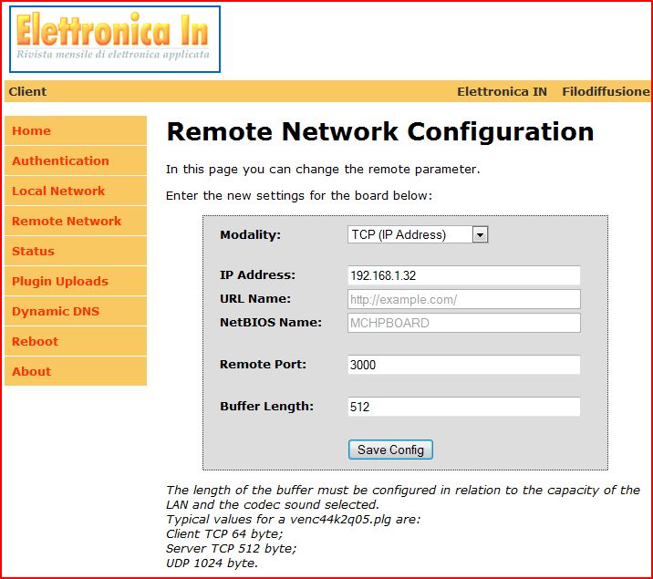

client and server can be on same lan , or connected by tcp everywhere, even with dyndns service !
my setup consist of :
+2 boards ,
+a router (same lan),
+an audio source (connected to client board) that is a old notebook with windows millenium (!) running a mp3 on usb stick. why such old pc ? becuase my ultra-mega super power notebook has only SPDIF audio out.......... and i can not test a mono audio signal with that.
+a speaker set connected to server board, only one speaker will work because i made a mono connection , just to test.

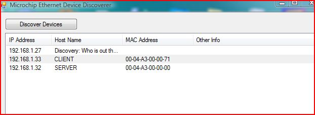

BOARDS : you explore them with a DISCOVERER TOOL
discoverer tool.JPG (28.7 KiB) Viewed 27646 times
you set using a browser : menu is very complete ! : authentication (set password...) , local network , remote network, dyndns, plugin upload etc.
plugin : what is that , should be eproom files with various settings of audio , i have 3 of them , but didn't upload anything new because with the preset works vey good :)
client settings.JPG (84.51 KiB) Viewed 27646 times
How good is audio quality ? GOOD ! i did a movie but what you'll hear is not that good , like i hear because my handycam is a cheap one ! and settings was MONO not stereo
