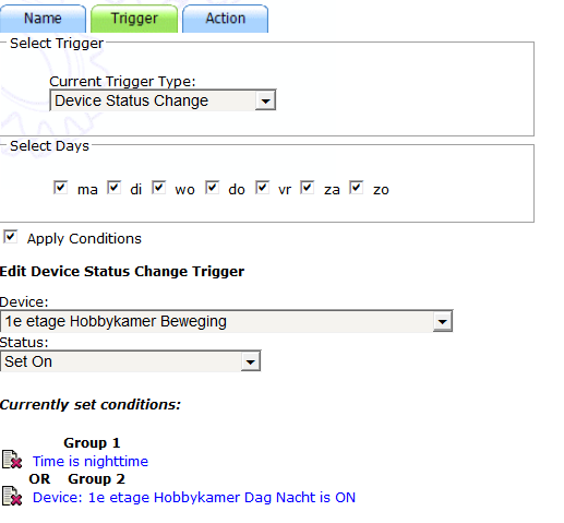

Re: Automatic hall lights question
Is this what you need?
It will will trigger at night and at day when it's heavy clouded.
Day Night is the light sensor that's included in a MS13A movement sensor
vanisher
Post by vanisher »
That's exactly what i want to do! Thx for helping me out.. The video is very clear how it works!
Edit: Just had the final test.. it works like a charm!!
