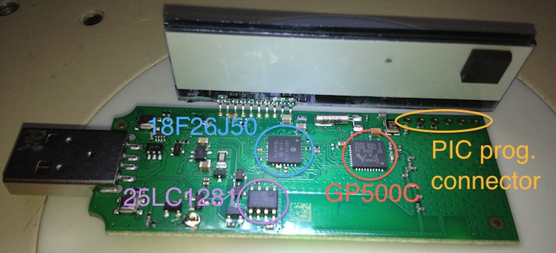

The manual says not to open it, and that's all I needed:
Insides of The Energy Stick
TES Stick inside.jpg (95.01 KiB) Viewed 3388 times
The TES stick is powered by a Microchip PIC18F26J50, which uses a 128kiB 25LC128 SPI memory chip for non-volatile storage and a GreenPeak GP500C for ZigBee communication.
The non-populated 5-pin header seems like a PIC programming connector; Pin 1 is connected to MCLR of the PIC, pin 2 carries the PIC's operating voltage and pin 3 is connected to ground. Let's see if I can get in with my RealICE.
When it communicates, it seems to use 2 base frequencies: 2450MHz and 2475MHz. I'm sure I can demodulate the bit streams with my signal analyzer, but I expect that to be pointless, due to encryption.
