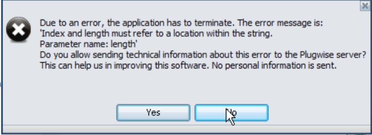

After the update to 2.23 and a restart of the PC on which it runs, I get the following error:
And then Source is closing, won't run anymore.
Now I can only view my data when I run PlugwiseServer.exe.
Also a restore of my backups didn't help.
I also tried running it with admin rights, no difference.
Tried going back to 2.22 but it can not recognize the updated database anymore, because 2.23 updated it.
Fix this a.s.a.p. please!
object reference not set to an instance of an object
Re: New Source 2.23 (20130301.0) release!
i had the same
started backup & restore, chose the last version... and up and running
