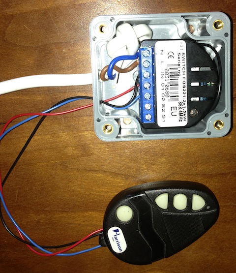

Via keyfob modification I have now made ​​them zwave enabled.
You need just 1 Fibaro switch FGS221

I've tried the keyfob modifications also, however that did also not give me a stable environment. Hopefully Harrisson will help me with some inside details...
Re: Harrison curtains wired control
I'm happy with this solution.
Just sending every command twice
With a short break of 2 seconds.
