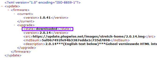

2) Okey, let's check the page/XML output of the stretch on http://192.168.x.x/update/firmware, the result is:
Okey, here is says there is a new one available!, still don't get it why i could not download it! :shock:

5) Okey, now the stretch is downloading the newest firmware that is anounced, just give the stretch 1 minute and look back in http://192.168.x.x/update/firmware
The result when the new firmware is downloaded on the stretch:

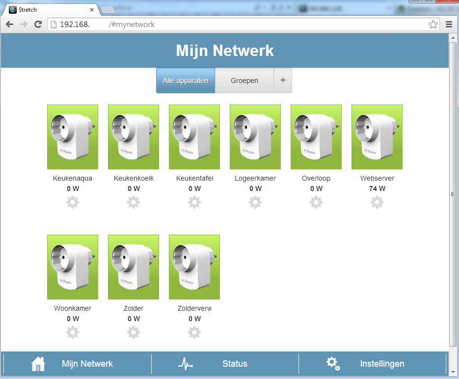

Tadaaa, this is how the new Stretch 2.0 firmware looks, now i can get further with PWScli! :D :D
