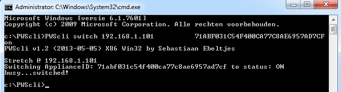

Here is a program where you can switch your PlugWise circles from the commandline, this way you don't need complicated programmer knowledge and can use this program from a "shell" command. (think of Excel, PHP Script, Homeseer)
Download: http://domoticx.nl/plugwise-stretch-2-0 ... interface/
Tested and working on:
– Windows XP 32-bit
– Windows Vista/7/8 32/64-bit
* Does not work on Windows 95 / 98 / ME due to unicode compile.
* Does not work on Windows Server 2000 (crash)
The commandline usage of this program is: PWScli.exe switch [stretchIP] [stretchID] [applianceID/CircleName] [on/off]
[stretchIP] = The IP adres of the Stretch 2.0
[stretchID] = The Stretch 2.0 ID code (8 letters)
[applianceID/CircleName] = The 32 characters of the ApplianceID or the name of the circle
[on/off] = Switch the circle on or off
SWITCH EXAMPLES:
PWScli.exe switch 192.168.1.101 abcdefgh 71abf031c54f400ca77c8ae6957ad7cf on > Switch a circle with the proper applianceID on, via the Stretch 2.0 on IP adres 192.168.1.101
PWScli.exe switch 192.168.1.101 abcdefgh livingroom off > Switch the circle named "livingroom" off, via the Stretch 2.0 on IP adres 192.168.1.101
PWScli.exe applist [show/txt/ini] 192.168.1.101 abcdefgh > Show's or exports a list with the names and applianceID's of connected circles to a txt or ini file

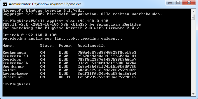

New version of PWScli released for Stretch 2.0 with firmware 2.0.x!
v2.0 (2013-10-10)
- Program adjusted for stretch 2.0 with firmware 2.0.x
- Note: This version is not compatible for a stretch with firmware 1.0.x
Screen:
Enjoy!
