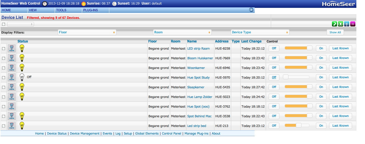

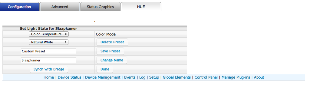

Here are some screenshots for the upcoming HUE HS3 plugin ….
1) It will automatically detect the lights and add then to homeseer
2) Support for multiple bridges (in my case there is a Philips HUE bridge and a Dresden Electronics) - each bridge can have their own api-key
3) Virtually unlimited custom presets (you can build a colour with your iPhone/iPad app and 'copy' to Homeseer
4) Pre-defined presets - 5 at the moment but easy to expand.
Todo
1) configurable bridges and username (api-key)
2) Event support with selectable preset.
Requires .NET 4.5 and JSON.NET
Todo

Re: Philips Hue Control Script
I added some more functionality, you can now set a device using a preset ...
