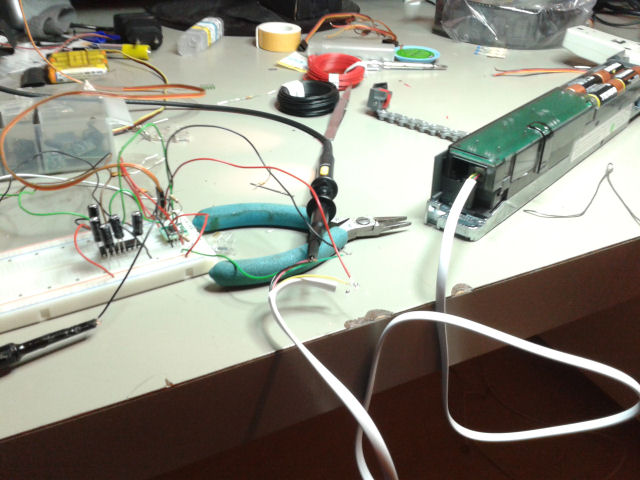

First picture
It is connected to the PC via an USB serial cable, To a max232 to convert the RS232 to TTL, and then a MCP2021.
This is almost the same as the MCP2003, except it as an voltage regulator of 5.0v internally that I can uses for the Arduino.
But it was a little bit strange, I couldn't get it to work. because I was sending "status:\r\n" at ones. But When I started typing and directly sending every character it started to work when I don't type to fast :-) ( And I am not that fast :-O.

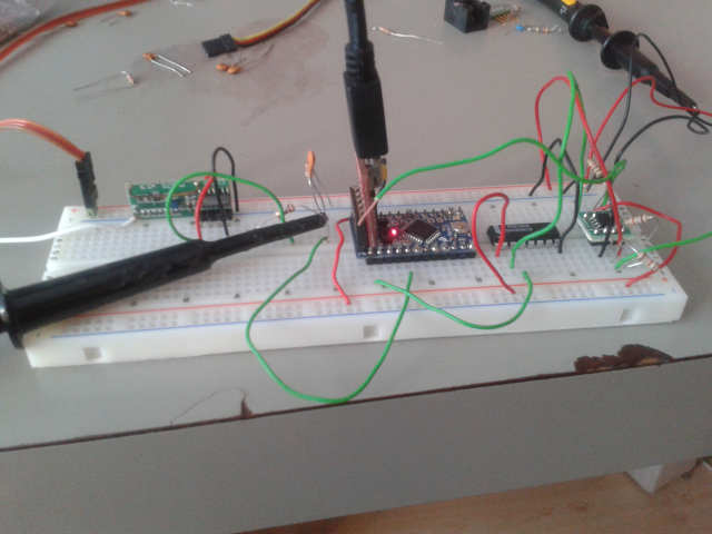

Second version (first picture) I use a Arduino pro mini 3.3 volt and the same MCP2021. and have a transparent serial to software serial communication.
I used the FTDI with the hardware serial, and connect the MCP2021 to port 3 and 4 for the software serial ( bit banging ).
That one worked pretty quick :-)
Now make a the arduino to type the characters and make some recovery mechanism, because a number of times it didn't work that well.

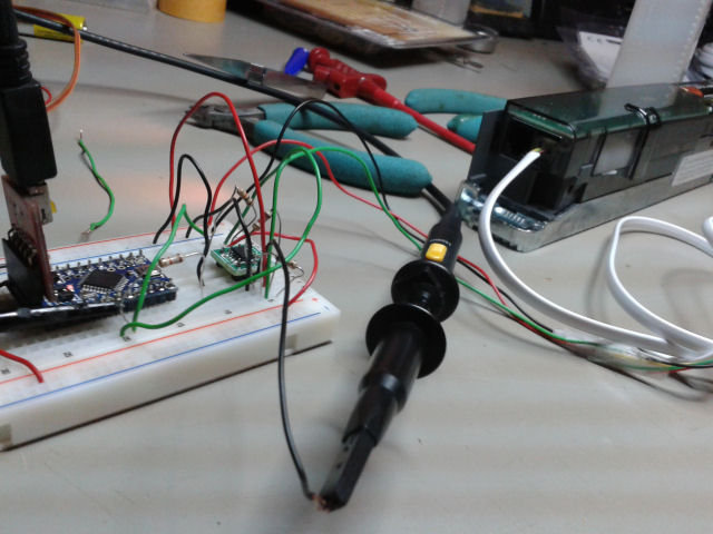

So after combining my Arduino KAKU receiver and the AXA control it didn't build any more.
Softwareserial is not compatible with pinChangeInt. Both use the same interrupt vectors. So I had to
give up my debugging serial port :-) and go to the hardware serial port for talking to the AXA remote 2.0.
Small problem with this is that I need to have a buffer in between the MCP2021 and the atmega328p.

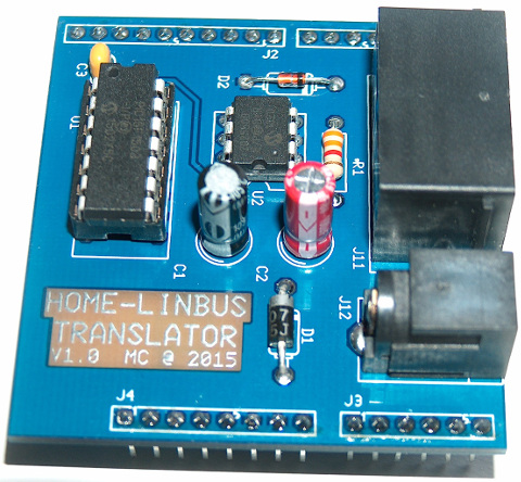

I would like to control the axa remote with a vera controller via an arduino. I have troubles to connect the axaremote to the mcp2021 and to the arduino. Could you please share the scemetic you use and sketch file you wrote?
Thank you in advance i will post my solution if i can get it working
Zoefnoef
Joined: Mon Jun 30, 2014 5:05 pm
Re: Controling AXA remote 2.0 with KAKU remote
Post by Zoefnoef »
Hi Driesk,
Did you see the Arduino Shield already for the Axa Remote 2.0 ?.
