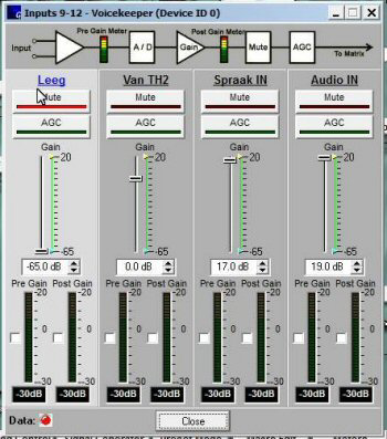

The image above shows the settings i use.
For now you are only intrested in input 12. This is the
input on the far right. Next you will see a rather impressive diagram of the inner workings of the XAP800. You will see a button
called 'inputs 9-12', click that one. Click on label 'input 12' and rename that one to 'Audio IN'. Next
check the checkbox next to the VU meter called <b>post gain</b>. This will give you an active volume level meter.
Start your media player with some music and watch the VU meter. Keep the gain at 0dB. Now use you volume
control on the PC to raise the VU so far that it is in yellow without going in to the red area. You might
need to adjust the gain on the input to get it right. For all levels it counts that they must never get
into the red area otherwise sound might get clipped.

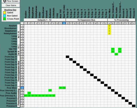

The image above is a view of the matrix in a full setup and is for reference only.

Close the input window and click on the button called 'matrix'. On the left side you see a label called
Audio IN. At the top side of the matrix you notice a few block and above the block called inputs there
are labels, click one of these and name the inputs with meaningful names like input 1 to Kitchen and
input 2 to Living room and so on. When that is done close the label editing window and you are back
in the matrix. If you click on the cross section of Audio In and Kitchen it turns green and you will
hear music in the kitchen. It's as easy as that.
However we are all tinkerers in heart and soul so we will add more features in the future and to be
prepared for this we will make a rather different connection. At first this seems to be pointless but
trust me it will be a big time saver in the future.
In the image above you see a green box at the crossing between 'Audio In and 'Proc Audio' that will
connect the audio to the sound processor. The out put of the processer is then connected to the livingroom
(Woonkamer in Dutch) via the green box at 'Proc Audio" and 'Woonkamer'.

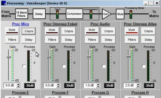

Remove the green cross section you made earlier. On top of the matrix, click one of the labels above
the To Processing block and rename processor C to Proc Audio. Make the cross section Audio In and Proc
Audio green. With the processor you can do al kind of processing on the signal such as filters and mute
with one button for all channels instead of each separately which takes time if you have many rooms.
To get music to a room you now activate the cross point at Proc Audio and the desired output.
