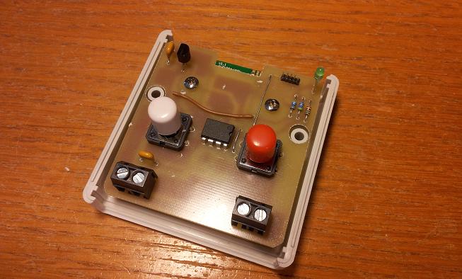

Some pictures of the unit:
Zigbee PWM dimmer
Zigbee PWM dimmer
The 2 buttons are for local control, the connectors are for 12V in and PWM out

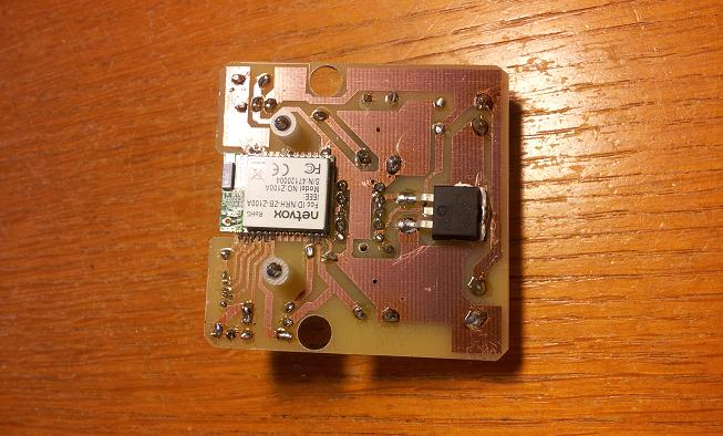

Here you can see the NetVox Z100A Zigbee module and the N-channel Mosfet for driving the load.
The Mosfet can drive many Amps without a problem (very low on channel resistance)
The design fits nicely in a Hammond box.
The unit confirms to the Zigbee HA profile. The device ID: 0x0003 (Level Controllable Output) and supports the clusters Basic, Identify, OnOff, Level Control, Groups and Scenes.
