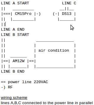

Hello,
this is my first home automation pet project so it would be really great if experienced users could verify my little project:
elements
DS13 - http://x10modules.com/shop/product_info ... cts_id=140
AM12W - http://x10modules.com/shop/product_info ... ucts_id=93
CM15Pro - http://x10modules.com/shop/product_info ... ducts_id=1
behavior
If turned on, the air conditioning turns off when the door stays open for more than some time (e.g. 3 s).
If turned off, the air conditioning turns on when the door gets closed.
Can I achieve the desired behavior with this system?
I believe I can because the transciever from DS13 signals door state change to the transciever in CM15Pro via RF and CM15Pro signal to AM12W via the power line to turn the air conditioning on or off. Am I correct?
Thanks for your time and answers.
