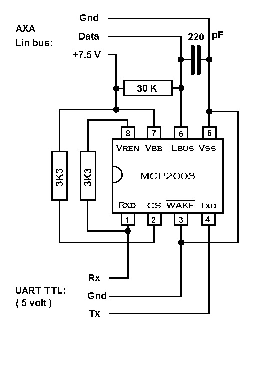

DomoRob
Joined: Sun Jun 21, 2015 7:48 pm
Re: AXA Remote Ventilation RV2900, Window opener
Post by DomoRob »
Someone asked for a schematic.
In am cotrolling an AXA RV2900 from my Raspberry Pi.
I use a pl2300 USB to UART TTL module to interface with the lin-bus driver.
This is the schematic of a working setup.
It works well with the Python script of kabelmanroel.
Schematic of the lin-bus driver
driesk
Posts: 9
Joined: Mon Oct 20, 2014 2:33 pm
Post by driesk »
thank you very much, i was so close. just missed a resistor. I can confirm this scheme works well with putty on win7. Only problem i have is that some commands are lost. cable length is 4m. I use a cheap pl2303 from a chinese website.
