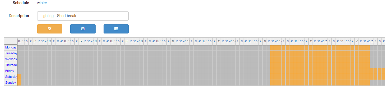

filling a cell with a number 1 to ? turns it light orange and displays the number (I entered 100).
- I suppose this is the Standby-killer function.?
- what is the upper limit?
Filling the cell with 0 turns it grey
- Grey means OFF?
filling the cell with -1 turns it orange
- Orange means ON?
Assuming Orange=ON and Grey=OFF; will the plug switch OFF at 10:00 or at 9:45 ?

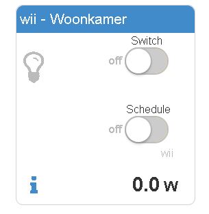

Should I toggle the "Schedule" switch to run the schedule?
- sounds logical, but does not work as expected for me; it simply switches the plug on and off without relation to schedule as far as I can see.

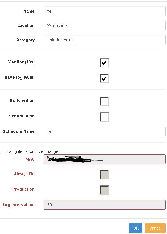

Plug config
Plug config
This configuration seems to follow of the above control box settings, so I guess this does not need specific settings to make the plug follow the set schedule?

-1 = On, 0 = Off, positive value = standby wattage. Range? I am not sure whetehr there is an upper limit. Circles are rate 3680 Watt max, so I suspect that any value between 1 and 3680 works. Next time I go really deep into reverse engineering I can check this.
The "10" column means 10:00 AM. the "45" column to the left of it 9:45 AM.
You indeed can enable the schedule through the "plug control box" as you expected. I assume that with the upper switch you are able to switch the circle on and off. If not we may have to figure that out first.
Now when you switch the schedule on and off, you simply observe it switches the circle on and off. This can be explained for the following situation: Your schedule is mostly "ON". If the upper switch is in the "OFF" position, and your schedule says "ON" for that timeslot, then the circle switches on on enable the schedule, and it switches the circle to the requested position of the switch setting, which may be OFF.
So this is how it is suposed to work. Obviously it doesn't as you already tried a lot. Can you check the following:
The settings panel is only needed to indeed define the proper schedule. What you can do to see whether it operates with schedule is use a special test schedule. Set the schedule to "__PW2PY__test-alternate" and in the control box schedule = ON, then it should start switching every 15 minutes.

First in the configuration window of the circle; I entered a new schedule name "_Wii"
Then I newly created that schedule "_Wii":
I edited the schedule into:
Everyday: OFF (cel value = 0 = grey) from 2:00 to 8:00

testing
testing
the light actually turned on at exactly 9:00 and off again at 9:30
it stayed off at 9:45
So without a doubt:
- orange is ON
AND
- 9:00 actual time is 10:00 in the scheduler
