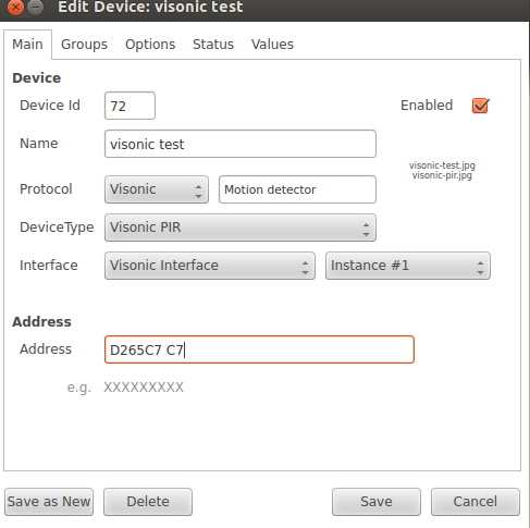

I'm using Domotiga with a RFXlan(868mHz). I want to visualize my Visonic-Sensors in my DomotiGa. In the debuglist I can see the information from the VisonicSensors.
2014/12/18 17:26:20 A9D2650CF3C780 MOTION[D265C7]S / 53861 Visonic motion sensor Alert addr:D265C7 C7 ID:425712014/12/18 17:26:20 [Devices] Device with type 'MOTION', address 'MOTION[D265C7]S' and interface 'RFXCom Receiver' not found!
2014/12/18 17:26:20 [Devices] Auto device create for 'MOTION device #1' failed because it's unknown!
2014/12/18 17:26:20 [Devices] Device type: MOTION
2014/12/18 17:26:20 [Devices] Address: MOTION[D265C7]S
2014/12/18 17:26:20 [Devices] Interface: RFXCom Receiver' (1)
2014/12/18 17:26:20 [Devices] Please report this to support@domotiga.nl
2014/12/18 17:26:20 [Devices] Also note that you can probably simply create this device manually, and selecting a devicetype similar to the one missing.
bits=41 from SLAVE
So.. How to configure the DeviceTab. I tried a lot but no luck..
First: Now I have Visonic Interface instead of RFXLan reciever.. But I can't select the RFXlan reciever
Second: What is the right Address of the Pir.. "D265C7 C7" or "D265C7" .. or MOTION[D265C7]S ???
Thanks already,
Ben

Hi Ben,
On your second point, based on the error message:
I would say, try 'MOTION[D265C7]S' as address.

Had a better look in the source code and database and think you should try:
Protocol   = X10SecMotion
DeviceType = Visonic K980
Interface  = RFXCom Receiver
Address    = MOTION[D265C7]S

Thanks Emvee,
That helps... It's working now.. :D
