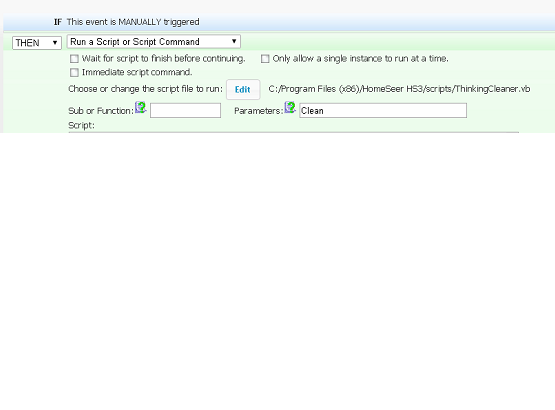

The script will automatically create the devices, which display the roomba status and also creates buttons to dock, en start cleaning. The script can also triggered with parameters to execute these commands. (Dock, Clean, Cleanmax)
event clean.png (26.93 KiB) Viewed 9214 times
