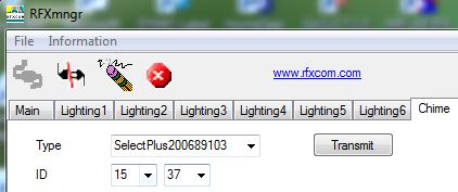

Witch device must i select to add this chime.
I select the Byron but there is only room for a 2 digit device code.
The remote has 4 digits.
I have read the manual 2 times but cannot find the answer.
Thanks in advanced.
Packettype= Chime
subtype= SelectPlus200689103
Sequence nbr = 6
ID = 1537
Signal level = 5
Ed

Use the latest RFXmngr version 15.0.0.0
