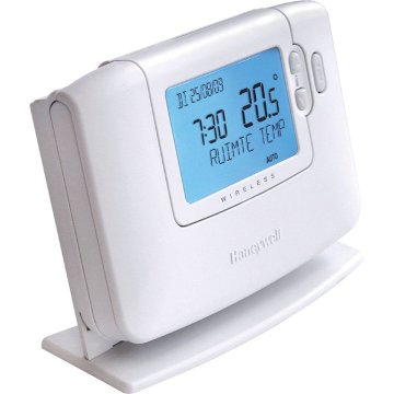

Posts: 2031
Honeywell Wireless CMT957M1011
The CMT957M1011 is actually a CMS927B(1015) control unit combined with a R8810A1018 OT relay box. (Thanks to D_Hailsham for figuring out and sharing these details.)
Features:
  • Does not support setpoint override
  • Always reports the room temperature as 20 degrees

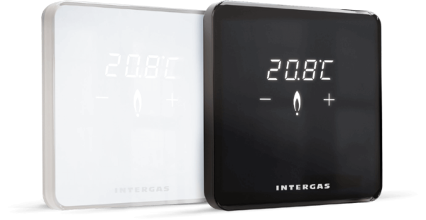

Intergas touch thermostaat
Post by Paul H te O »
  • Supports setpoint override, by HS4 plugin from Bernold OTGW plugin (Resolution 0.5°C)
  • Nodo Shop OT gateway works fine
