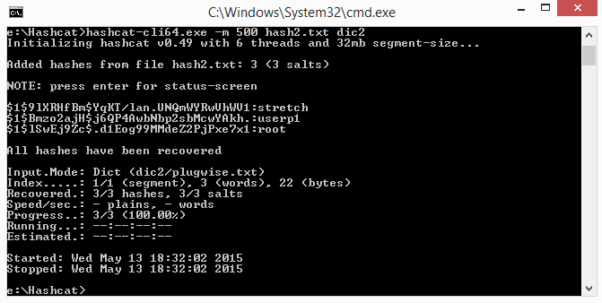

So we have these (salted) UNIX MD5 hashes:
user "root":
$1$lSwEj9Zc$.d1Eog99MMdeZ2PjPxe7x1
user "stretch":
$1$9lXRHfBm$YqKT/lan.UNQmWYRwVhWV1
user "userp1":
$1$Bmzo2ajH$j6QP4AwbNbp2sbMcwYAkh.
Well they aren't that hard ;-), it seems that are the same password as the (user)name:
user: root, password: root
user: stretch, password: stretch
user: userp1, password: userp1
Here is a hashcat screen of the results:
plugwise hashcat results.png (12.11 KiB) Viewed 11584 times

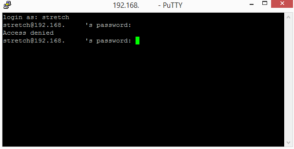

But entering these in a SSH session doesn't work:
plugwise ssh result.png (5.71 KiB) Viewed 11584 times
So why can't we login with these credentials? am i missing something?

* Password based authentication might be disabled, thus requiring SSH keys
* The user you are trying might not be in the AllowUsers
* PAM might restrict other things
All kind of reasons thus ;)
Only 'real' way to see what goes wrong is to check the logs on the server side.
You might find some hint in the PuTTY Log, but as you can't change anything on the server side nothing you can really do.

nginx has little/nothing to do with sshd. You would have to check the logs on the server side (thus the smile/stretch) and likely those logs are not stored on any saved medium which one can inspect.
Note that the 'shell' in the password file might be restricted too. /etc/shells typically contains a list of 'allowed' shells, hence if /bin/ash is not there then that user effectively cannot log in (at least not without some tricks/settings etc).
jeroen_ wrote:You might find some hint in the PuTTY Log, but as you can't change anything on the server side nothing you can really do.
Note that PuTTY is the SSH client you use. Those logs (PuTTY Logs) are thus client side. (click on the program icon in the top left of the PuTTY Window and there is a log there). This will likely show that public-key auth or password auth or rejected or not.
We already can get in the system (due to failsave mode and change password) but the trick is to get the 'original' password, withouth flashing or jailbreaking the device...
Passwords are irrelevant if the system does not use them.
