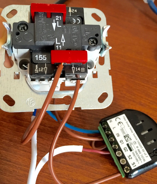

Team,
When connected, the pulse switch switches on the light as long as I keep it pressed..
Fibaro Relay switch
Fibaro Relay switch
The white (split) cable going down is connected to a lamp
Fibaro: S1 goes into the switch
Fibaro: Q1 goes to the lamp
Fibaro: IN is connected with L
Fibaro: L & N to 230v
Switch: other connection to L
It feels like I have connected the switch the wrong way ;-)
Fibaro parameter 14 (0=momentary switch, 1=toggle switch) have been tested with both 0 and 1. Same result.
Any idea?
Cheers
Dirk

This should be the schematic you are using but i cannot figure this out using the picture. Are u using fixed cable or a wallplug so are u sure L1 is L1 and not Null because the wallplug is connected up side down?
If you measure the brown wire and ground do you measure 230Volt?
I think parameter 14 should be 0 and it should work fine then

I think the problem may be in the Pulse Switch, of which I have no idea which cable should go where ;-)
The schematic you attached is the one I used to connect everything.
After measuring I found that connecting the wires as they are right now (in #11 and #14), clicking the switch would momentarily switch it on
Don't have any schematics or details on the Gira Pulse Switch (015500?)

Usually this is straightforward (RED / P / L) is the input and the outgoing arrow is the output.
When u remove the switch and use the naked wires (WATCH OUT HIGH VOLTAGE!!) and connect them for a second is the fibaro working as expected then?
Note: If you deassociate the fibaro al settings are lost (atleast for my fibaro versions) so are u sure that option 14 is still set correctly ?

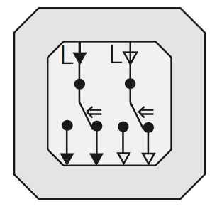

Think this is the schematics for the Gira 0155 00 pulse switch
Gira pulse switch schematics
Raymond: Using a wall plug and your "up side down" comment might be very smart ;-). I will check!
DJF3
Posts: 895
Re: Fibaro Relay 2x1.5kW with pulse switch?
Post by DJF3 »
raymonvdm wrote:Are u using fixed cable or a wallplug so are u sure L1 is L1 and not Null because the wallplug is connected up side down?
Brilliant... This solved the problem ;-)
