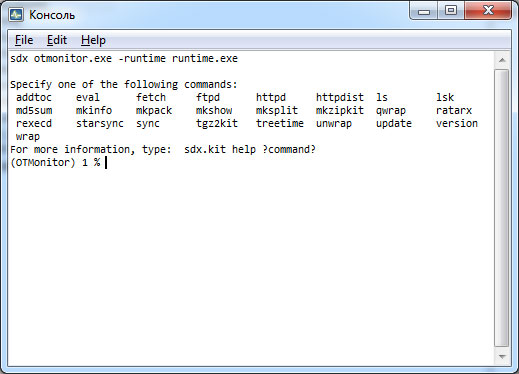

I want to make some changes to otmonitor.
When I try to collect single executable by this instruction http://otgw.tclcode.com/otmonsrc.html.
I see this picture. No any exe file create.

Can I suggest that you re-read the instructions in the link as you do not seem to be following them exactly? For example your command line says "sdx" while it should be "sdx.kit"

Need correct http://otgw.tclcode.com/otmonsrc.html
linux → linux
./tclkit sdx.kit wrap otmonitor -runtime runtime
linux → windows
./tclkit sdx.kit wrap otmonitor.exe -runtime runtime.exe
windows → windows
windows → linux
Posts: 2031
Re: Unable create single exe from source
I was sure I tested the commands that I posted on the web page. It's a mystery how the "wrap" disappeared. Thanks for the correction.
