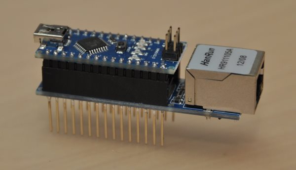

Last Friday I received some goodies from China: an Arduino Nano + Ethernet Shield:
Really very small, cheap (17 euro) and programmable, since there's an ATMega328P on it.
Whether you want it to upload sensor data from the Nano with http, or do http calls to the Nano, it doesn't matter.
Want your smart meter data presented in the Fibaro HC2? Just change the sketch for the Nano and you're done :)
I (almost) did that :lol:

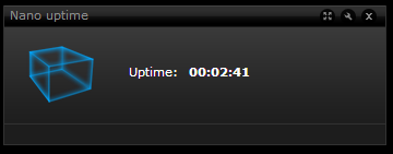

Here's what I've been doing with it last weekend:
http://blog.hekkers.net/2014/06/15/flex ... n-20-euro/

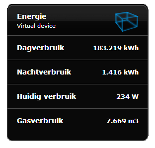

I finished what I (almost) did a week ago: adding a smart meter to the Fibaro HC2. With hardware costing only 17 Euro (and a free port on a switch)
P1 Smart meter in Fibaro HC2.png (13.8 KiB) Viewed 24140 times
http://blog.hekkers.net/2014/06/22/addi ... ibaro-hc2/

I bought an arduino nano and i got the serial out, by means of the serial monitor on the laptop, but i don't know who to apply the last bit of code from your website in my script, to show up in the fibaro hc2, virtual device.
void loop() {
c = mySerial.read();
switch (c) {
case '/':
receiving = true;
break;
case '!':
receiving = false;
break;
if(!receiving) {
if (ether.packetLoop(ether.packetReceive())) {
ether.httpServerReply(readingsPage());
Because some code is missing and my programming in arduino is not outstanding.
