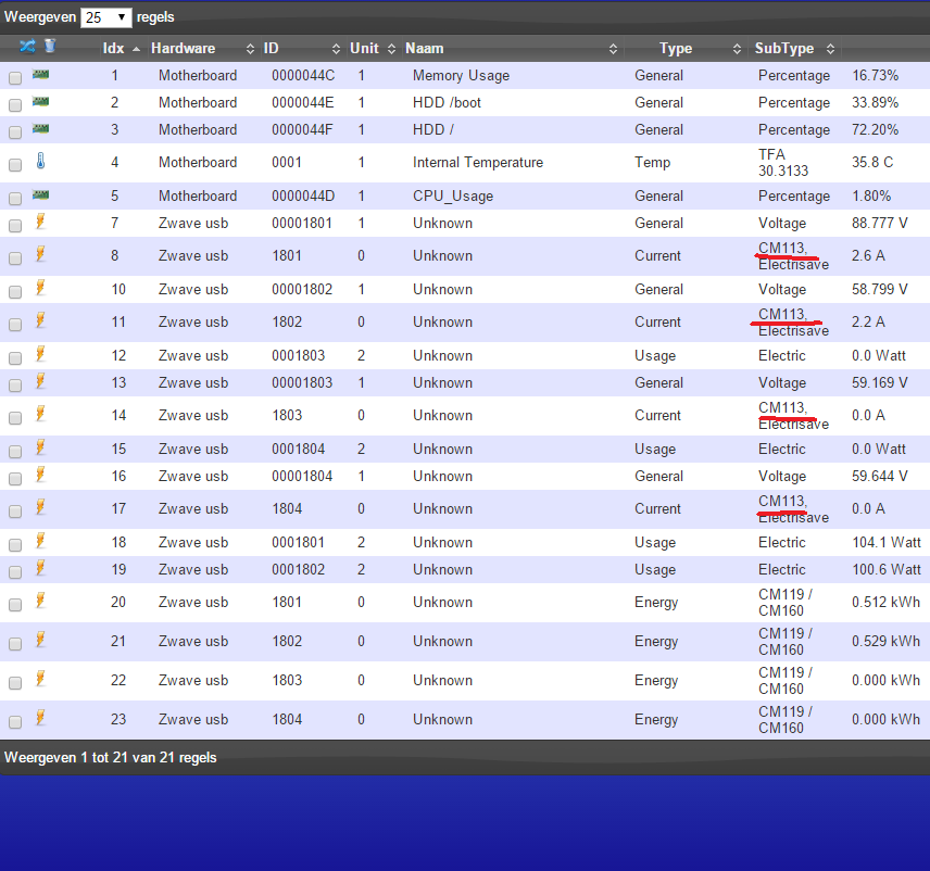

The next thing is that in my devices overview i can see 4 CM113 items...but i only have 3 clamps.....how is it possible that it shows 4 measuring value's.
See picture
