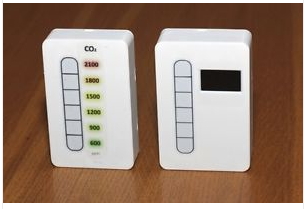

Hi guys
i got in contact with Vladimir
check this C02 sensor (update: also with MQTT now)
http://vair.anker-bg.com
http://vair-monitor.com
http://www.ebay.co.uk/itm/281890179126
there is also a version with a small lcd screen
it has got wifi and can upload to a site.
I got in contact with him and he made the upload url flexible so you can upload every x seconds (adjustable)
to for example 192.168.1.10:8080
also you can ask for a nice price and shipping is only around 3 euro.
He made this during a funded Kickstarter, check it out
Im getting 2 pieces soon and will be able to test it

Re: CO2 Sensors
I also would like to test a unit
Did you order the version without display? And is vladimir also a forum member?
Re: CO2 Sensors
With display and wifi, no he is not a member yet, but mail him and mention me, then he knows which version firmware etc.
Re: CO2 Sensors
I am the producer of the "v.Air - CO2 Monitor". (@Pieter, thank you for posting about my device!)
If you would like to order devices - just send me a PM. On the page above you can find some more details and prices of the devices. Also you can have a look on the kickstarter campaign for the motivation of building the device.
If you have any questions (or even better - feature requests) - I will be happy to answer
Regards, Vladimir
Regards, Vladimir
Re: CO2 Sensors
Hi Vladimir!
Great project, nice CO2 meters. I might order one soon. One question: how accurate are your sensors (how are they calibrated)?
Thanks!
Thanks!
