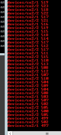

I Updated the firmware and now my C02 sensors are using MQTT :)
