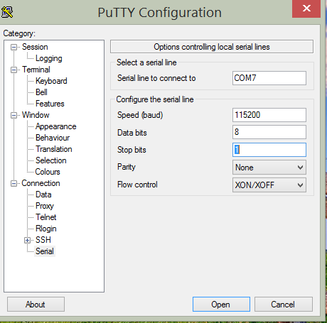

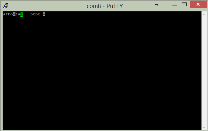

Hello, unfortunately no progress has been accomplished from my side yet.
Im still stuck at the booting process and i can't even do a reset to boot my Toon.
If you have any information on resetting Toon to his original setting(or better, rooting FW 2010.9-R10), please let me know.

I want to root also my Toon. So I follow the steps you described. I use the usb serial cable of the opentherm gateway from Schelte.
I connect with putty to the serial poort with the settings you described also. The putty screen stay's black nothing happenend. When I enter or type some characters are displayed in the terminal session.
Hereby also some screenshots
