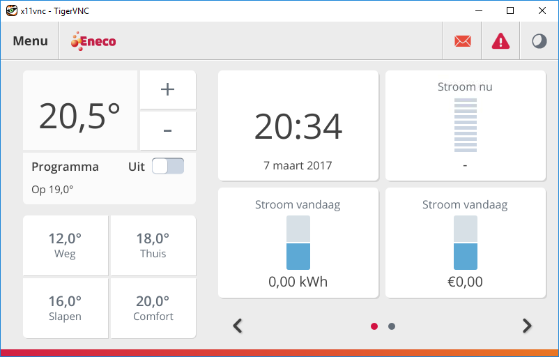

Hello, with the help of this forum/members, I’ve finally rooted a Toon, but unfortunately I’m now unable to connect to my wireless network.
I have rooted this Toon in my attic where I have a router with the same SSID and Password as in the living area.
Once the Toon was rooted, I’ve installed it in my living room but was unable to connect it to my wifi.
In fact, wifi connection icon was disappeared (see screenshot of my Toon).
I’ve tried several Linux command like :
iwconfig wlan0 essid Wifi key s:wifikey
Scanning does work and shows all the available wifi networks, but connecting to one is impossible.
I’ve even manually added my data to /etc/network/wpa_supplicant.wlan0.conf but somehow, Toon is changing the mac address to the router in the attic.
I’m unable to change my settings as once I do a reboot, all the changes I made will be overwritten by previous data.
I hope you’ll be able to help me out.
Thanks in advance

Re: Toon firmware: issues (and solutions)
You didn't accidentally disconnect (one of) the wifi antenna leads while reassembling your toon? When you scan for networks, what does that say in the message log (output of dmesg)?

All cables were connected correctly and Toon was even able to scan and find all the surrounding wifi connections, but it was unable to connect to one.
As last resort, i did a factory reset and during the initialization, i was able to connect to a new access point.
So i did and now i'm connected to my wifi router.
But in case i install a new router, i still need to do a factory reset to my Toon, but that's OK by me, as i have a rooted Toon :)
MarcelR, thank you so much in making this information available and a BIG THANKS to all the members in contributing to this site.
I'm Happy :)
