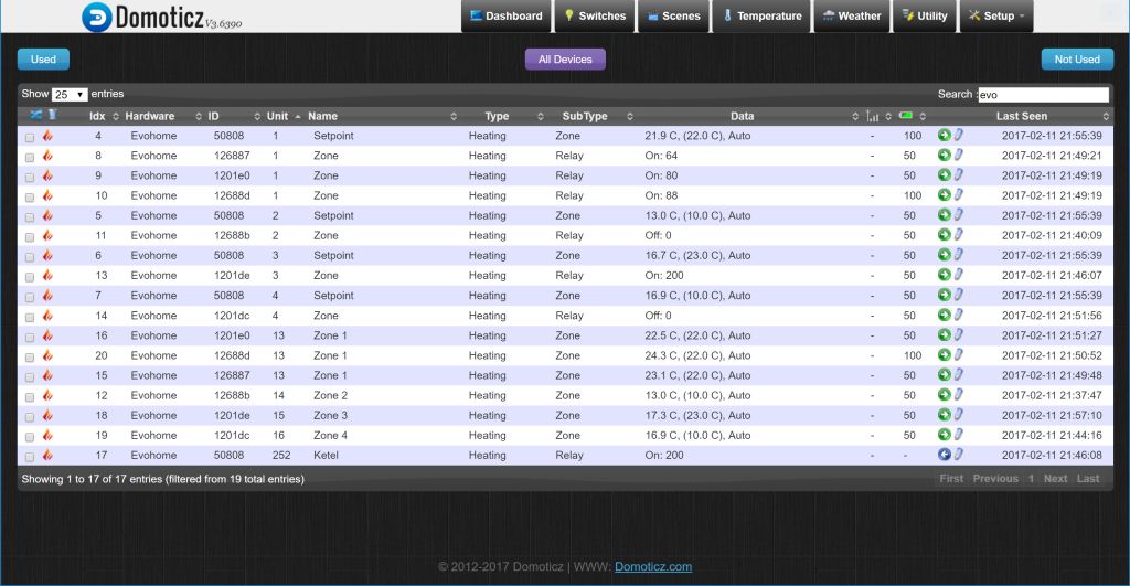

Okay, looking good. When not working on the firmware I read up on domoticz integration. So I felt fairly confident that now that my output was nice and clear, it was easy to add it to domoticz.
After plugging the UartSBee into the Pi running domoticz I did a quick smoke test to see if the data was coming in alright. And it all still looked nice and proper. The UartSBee used the FTDI USB chipset. In several places I found reports that this chipset might cause problems on the Pi due to high interrupt rates. In my setup, a Pi 2B running 4.4.38-v7+, I have detected no problems at all.
Next domoticz. I added new hardware choosing 'Evohome USB (for HGI/S80)'. Clicked 'All Sensors' and made a cup of tea. After fifteen minutes or so, I got a nice list of devices for evohome.
Great! I see my controller (a colour, wifi version) and six HR92's (three in zone 1, the living room).
And so I finally come to my question, why don't I see my on/of relay BDR91? I know it's there and communicates. The messages from device 13:212992 are there to prove it. I was expecting a device with matching ID 4F4000 in the domoticz device list. It is not there. Obviously I need to do 'something', or is the BDR91 never present in the device list? I have combed carefully through as much documentation as I could find online but can not find the answer. Can any of you provide a pointer or hint?
Thanks in advance,
Fred

Hi Fred,
Thanks for posting all of the details of your set-up and the logs. They are very helpful in troubleshooting your problem.
The simple answer to your question though is no, the BDR91 won't appear as a separate device in the Domoticz device list. The Domoticz Evohome code currently creates devices for temperature sensors and heat demand relay devices, but not for additional BDR91s unless they are used for switching the boiler or DHW. It looks like your BDR91 is used to control your boiler and this is device no 252. The 'All Sensors' function add all temperature sensor type devices to the device list, but there isn't a similar function to add all relay type devices.
It's great to hear about your success with the RFBee + UartSBee. I've just set one up myself in the last 2 days. Have you had any trouble with sending messages with the device e.g. changing a zone setpoint within Domoticz? Other users have reported some difficulty sending with the FullTalgoRythm firmware and I'm having some problems myself.
Another comment is about the incomplete messages that the RFBee + UartSBee was receiving. I think that these are coming from another non-Evohome system. I think it's likely to be something like a Honeywell CMZone system which uses the same wireless protocol. The device type 12 is used by the CMZone controller, but there may be other devices too. I don't know what device uses type 12.
Dan

Hi Dan,
thanks for your reply. I figured already that the relay would not show up, glad you confirmed it.
Device 252 is the demand as it is requested by my controller indeed. I'm just showing that as the boiler status, although the true status of the BRD may different should it miss a message. Nevermind.
To answer your question I had not tried sending a setpoint. I have done so now, and my controller is NOT picking up the settings I pushed from Domoticz.
