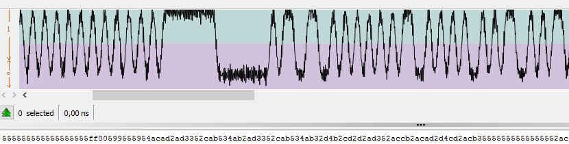

Hello I'm new in this interesting forum.
I heve an evotouch controller and 5 THR092HRT.
As I have a SDR(software defined radio) where I can see the RF comunication directly.
- FSK demodulated signal and digital data
- sdr.jpg (26.69 KiB) Viewed 22187 times
Re: Evohome / Evotouch Wireless protocol?
Continuing the last post.
I inverted the signal after the sync FF00 plus additional 2 bits (ff008) to get
aaaaaaaaaaaaaaaaaaff00833555355a9a96a966569aa565aa6a966569aa565aa6695a699696a9
so I get the sync bits 335553
After the 29th byte I make a Manchester decoding:
0ee7946f13de51bc4f58da6791eb7b98a7b40000000
At this point I could not decode futher like it is in download/file.php?id=1396
Also the RFBee and CUL data showed different results.
The SDR work was a test only, to see real data of the CC100 RF output.
In the end I'm interested in an Arduino + CC1100 modul.
Does anyonyone have a running Arduino-Code which communictes with EVOtouch
Hox
