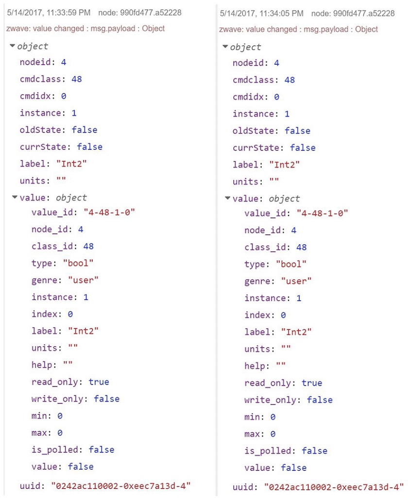

I'm having a few Qubino's and are not able to get the additional inputs (binary sensors) to work (I2 and I3).
I've tried it with Vera Plus, and concluded this is not supported. Moved over to Node-Red and finally got the events in when pressing I2 or I3.
Now running into the issue that the message I receive for I2 and I3 is equal. so don't know how to differentiate and trigger different scene's.
Anyone a clue on how to deal with this?
See the screenshot below, there you see the message payload for both I2 and I3. they are exactly the same.
Thanks!
bram
