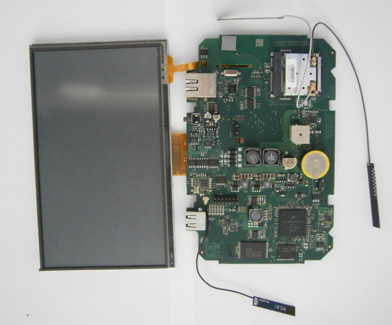

When I opened my toon I disconnected the antennas and now I am not sure which antenna goes to which connector.
I have wifi, but I can not connect to the meter modules any more ...
Can anybody post some pictures of the atenna/connector configuration please
Re: Rooting Toon (or boxx)
Like this:
It's a early toon (serial < 3000). Later versions have the antenna pads glued to the grey casing. Anyway, you can't go wrong, really, since the wire lengths are such that you can only connect them to the right connectors. A wifi antenna cannot be connected to the z-wave interface, simply because the wires are to short for that.
Good luck.
Good luck.

Thanks marclr!
I saw that on my motherboard on the opposite side there was another atenna connector. So there are 4 connectors in total and only 3 antennas to connect.
Anyhow, I now got my meteradapter connected again (repeating several times the connection process).
Thanks
Thanks
In newer toons the z-wave interface has two connections as well.One on each side of the MB.
